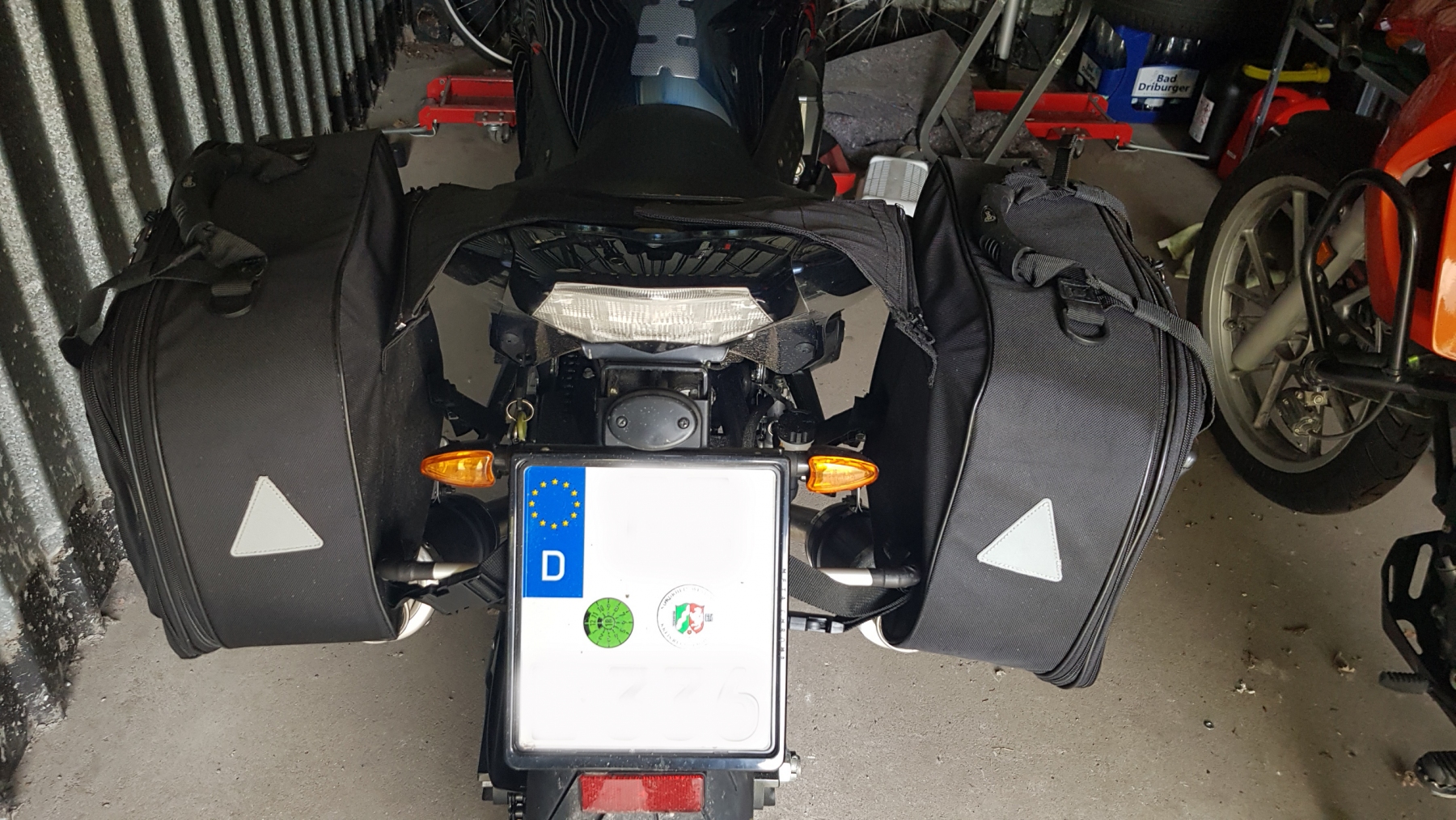

I bought the softbags already a few weeks ago. They actually provide enough room for 1 person to go on tour for a few days.
Because, remember, what does the biker need on tour? Toothbrush, corresponding paste, soap, one set of underwear and a tube of detergent. Oh, and two credit cards if on the way something is missing.

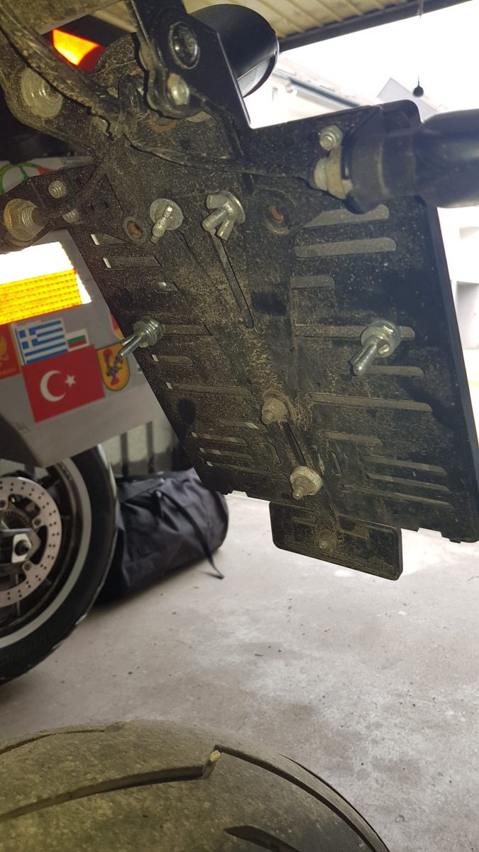

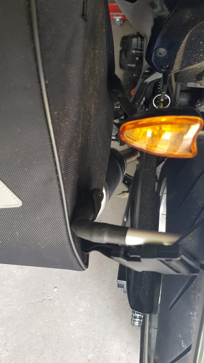

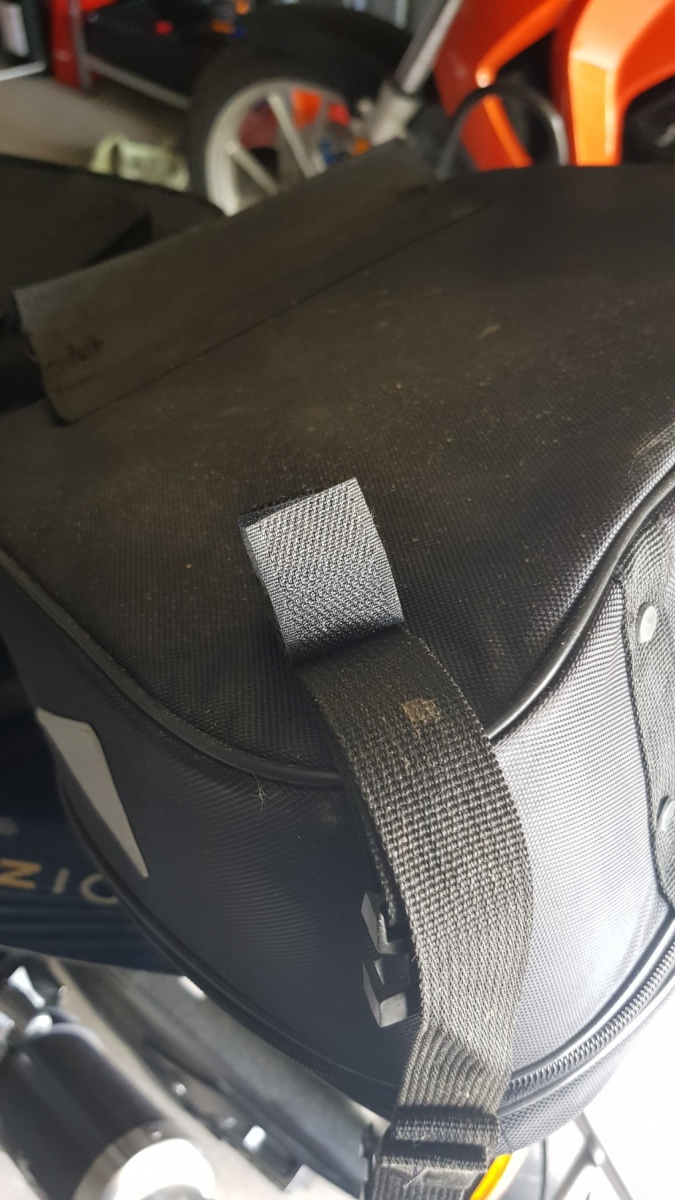

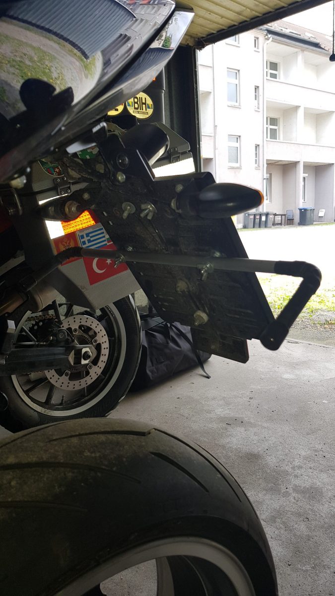

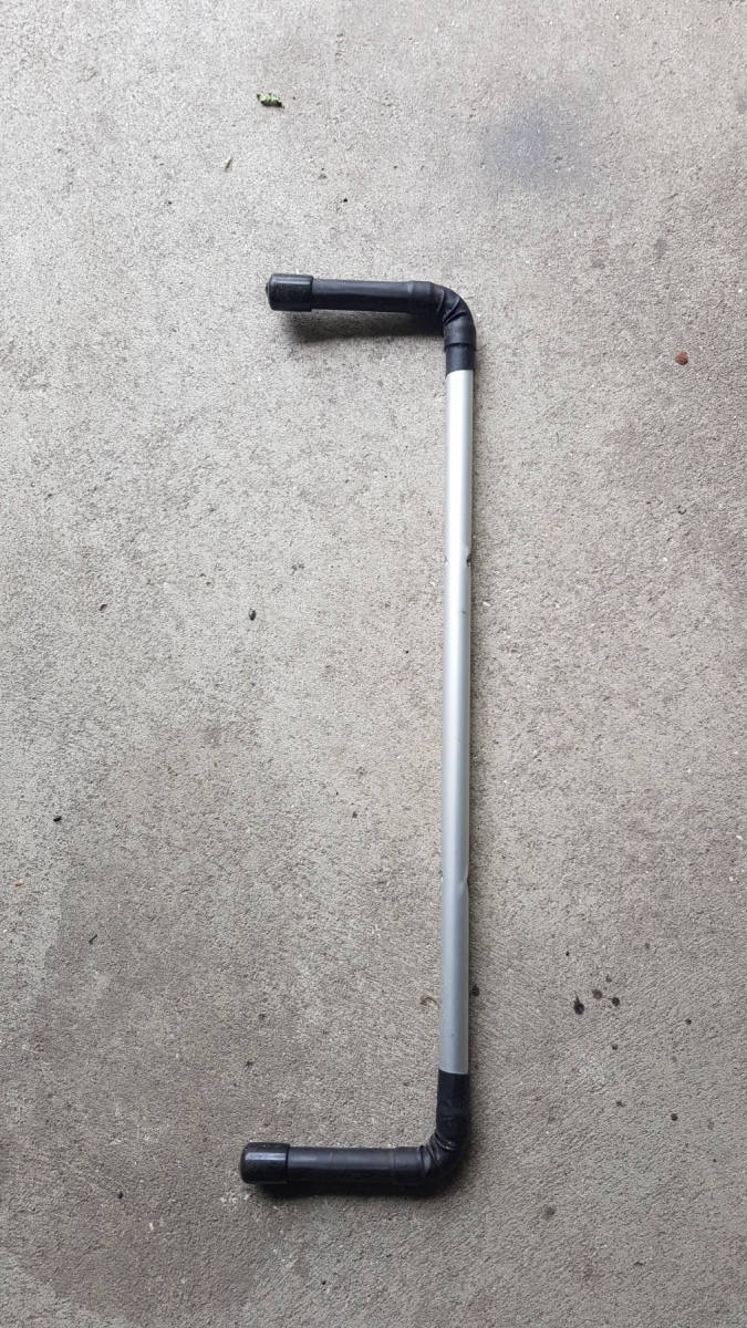

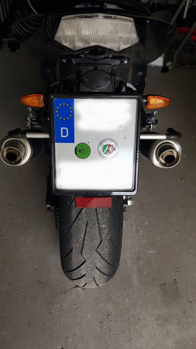

As you can see above, I was able to solve the problem with the pockets hanging inwards via a small self-construction. A few centimeters of aluminum tube (12mm diameter) a few copper fittings from the plumbers need, some metal glue (I can not solder or weld) and a little heat shrink tubing around the connections, the whole attached to the license plate holder with wing nuts (TÜV, can be without tools remove), the small loops of thevcheap panniers attached to it and already everything holds much better.
Financial expenditure approx. 5 €, time expenditure approx. 30min.
Total cost for panniers and “holder” 50 €
